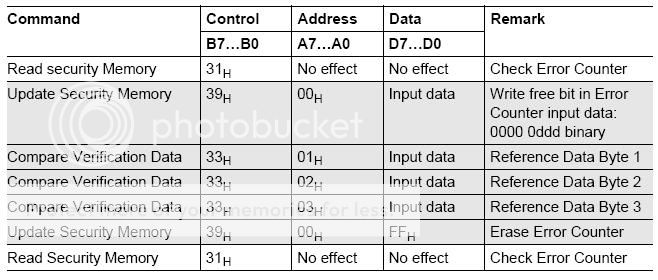

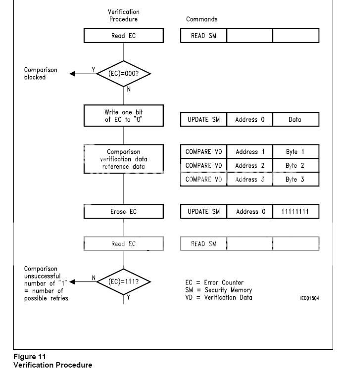

Aqui esta todo el código en C++ (es para poder leer/escribir una SMART CARD SLE 4442), estoy tratando de entender mas que nada los comoandos de escritura:

unsigned char smcver (unsigned char p1,p2,p3) {       // verify PSC code
    unsigned char mask,i;                             // out 0=OK 1,2,3=Error
    mask = 1;
    smcread (0x31,0,4);                     // check error counter (EC)

Segun lo que entendi de la datasheet, es necesario introducir un codigo de 3 bytes (en las genericas es FF FF FF) antes de cualquier proceso de escritura en la tarjeta. Para introducir este codigo, se debe realizar paso a paso un procedimiento llamado PSC Verification (el cual implica comandos de escritura, lectura, etc.)
Adjunto aqui el diagrama de bloques del procedimiento Verificacion del PSC (Codigo de Seguridad Programable) obtenida de la pagina 22 del datasheet de la SLE 4442 de SIEMENS (no puedo adjuntar el datasheet porq es muy pesado :cry: ):
Y aqui transcribo lo que dice el daatsheet sobre como escribir en la EEPROm de la tarjeta (que es lo que me interesa)
"PSC Verification (SLE 4442 only)
The SLE 4442 requires a correct verification of the Programmable Security Code PSC stored in the
Security Memory for altering data if desired.
The following procedure has to be carried out exactly as described. Any variation leads to a failure,
so that a write/erase access will not be achieved. As long as the procedure has not been
successfully concluded the error counter bits can only be changed from “1” to “0” but not erased.
At first an error counter bit has to be written to “0” by an UPDATE command (see figure 11) followed
by three COMPARE VERIFICATION DATA commands beginning with byte 1 of the reference data.
A successful conclusion of the whole procedure can be recognized by being able to erase the error
counter which is not automatically erased. Now write/erase access to all memory areas is possible
as long as the operating voltage is applied. In case of error the whole procedure can be repeated as
long as erased counter bits are available. Having been enabled, the reference data are allowed to
be altered like any other informaciónrmation in the EEPROM.
The following table gives an overview of the necessary commands for the PSC verification. The
sequence of the shaded commands is mandatory.
As shipped, the PSC is programmed with a code according to individual agreement with the
customer. Thus, knowledge of this code is indispensable to alter data."
Bueno, espero no haberlos dormido tanto con tanta charla, ojala puedan ayudarme.
