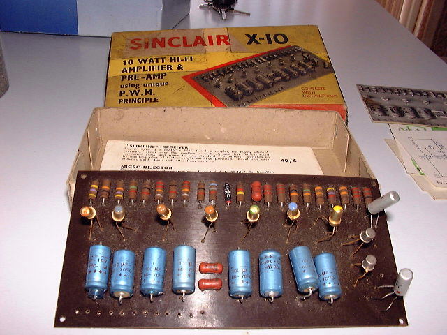

no lo van a creer pero mi abuelo en su taller gigantesco tiene un monton de cosas viejas y chucherias, hace cuestion de 1 mes fu a su taller queda en bariloche muy lejos de aca y revisando encontre una caja de sinclair z12 con su placa totalmente destruida comida por el occido y sulfatada totalmente lamentablemante no se pudo salvar voy haver si hago este con algunos componentes de la otra placa para que parezca de los años 70 jajaja. es igualito a este http://www.nvg.ntnu.no/sinclair/audio/z12.htm

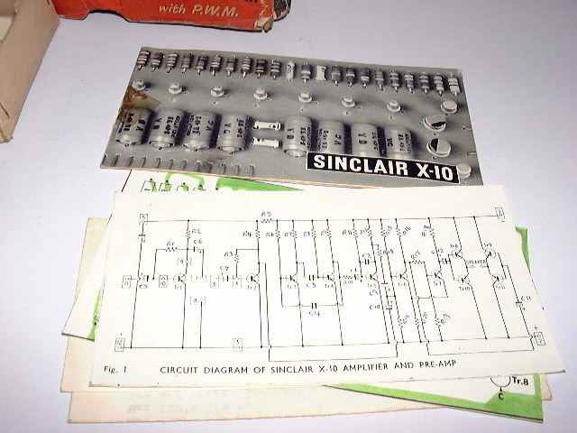

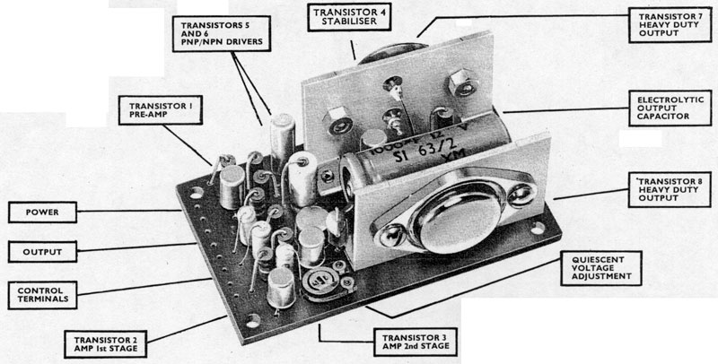

Que buen aporte... me he entretenido mirando las imágenes que acompañan el z12. Diseño del 66, y utiliza transistores de germanio... me habeis encendido la mecha. Vamos a intentar recuperar este precioso circuito. No estaria mal disponer de un amplificador con componentes de germanio...
y el artículo que acompaña las imágenes:
The Z12 amplificadorfier replaced the X-10 - which was by now something of an embarrassment for Sinclair - with a pre-built device. Its manufacture was subcontracted to one Harvey Hall who was running a factory in a Nonconformist chapel in Thetford, half way between Cambridge and Norwich. The factory had been started by Cathodeon in the 1950s, as part of the policy of the Pye Group of bringing employment to a wider area.
Although it was claimed to achieve "laboratory standards of performance", whatever those may be, its performance and reliability were questionable. It reportedly only achieved a maximum output of three watts, despite being advertised as being capable of 12 (hence the name). Its lifetime was also problematic - if run continuously at full output, as little as 12 hours (presumably not alluded to by the name). The problem probably lay in the fact that, like many Sinclair products of the time, it was built with cheap transistors that had been discarded by other manufacturers as rejects. Despite these difficulties, the Z12 was a reasonably successful product and remained a part of the Sinclair line until manufacturing difficulties ended production in 1968.
The Z12 eventually became part of a wider range of hi-fi products comprising the PZ3 and PZ5 power supply units plus the Stereo 25, a control unit providing volume balance and tone controls for the Z12.
Tambien nos habla de un X-10 y alguno más.
