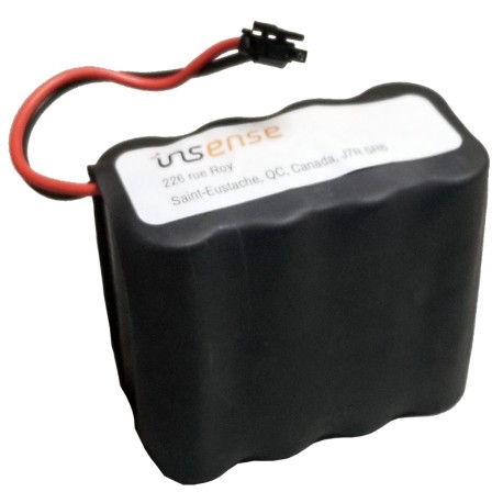

EJEMPLO: BMS 2s4p = Dos paquetes de 4 celdas en serie.
2S4P 7.4V 12000mAh Battery Pack
View larger
  • 2S4P 7.4V 12000mAh Battery Pack
Online only
2S4P 7.4V 12000mAh Battery Pack​
Condition: New product
High-quality 2S4P custom battery pack made of 8 pcs Li-Ion icr18650 battery cells. Our battery packs are built with high-quality BMS modules that guarantee extended life cycles.
El módulo BMS, en este caso se encuentra ya incluido en el paquete.
